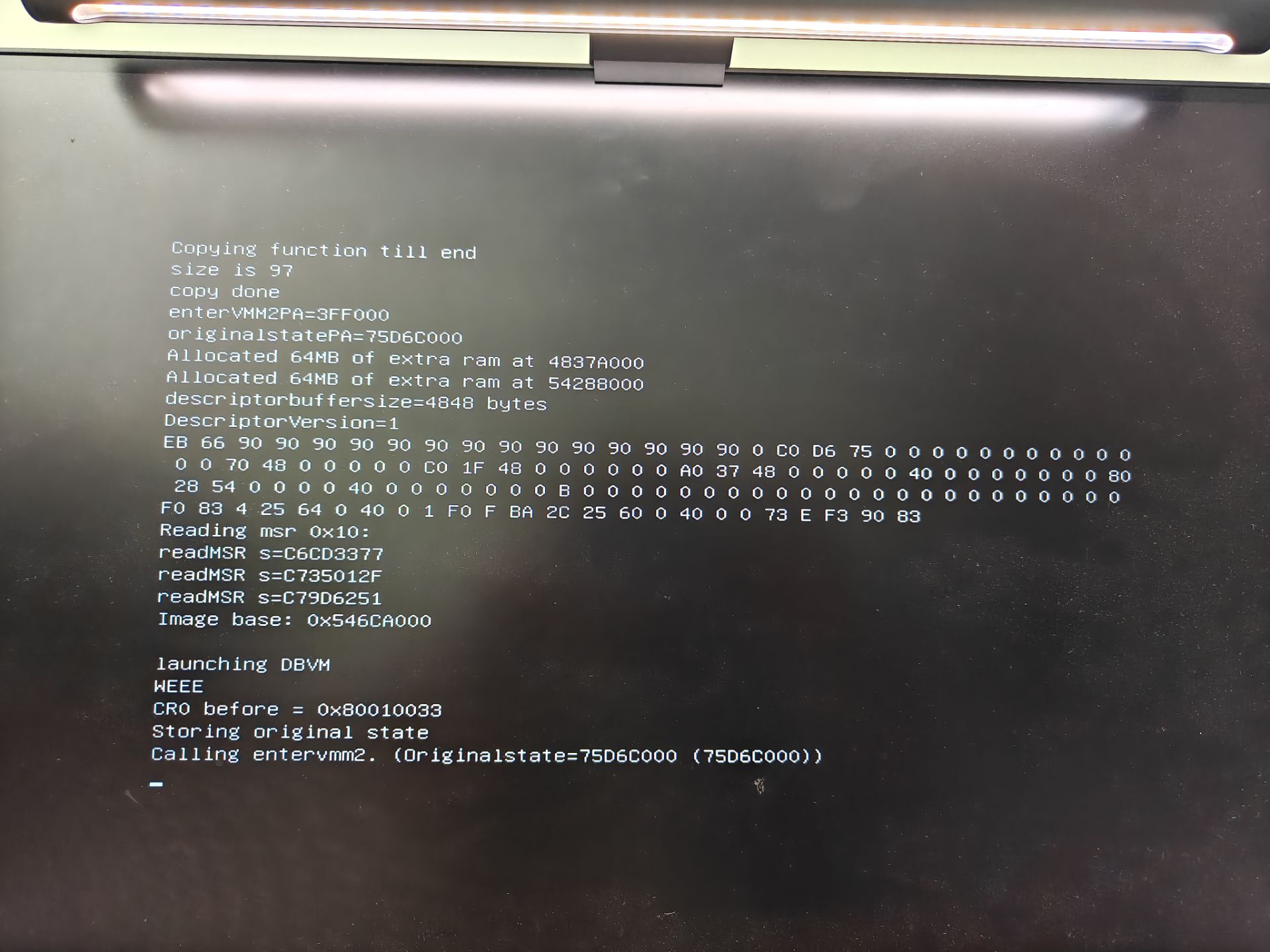

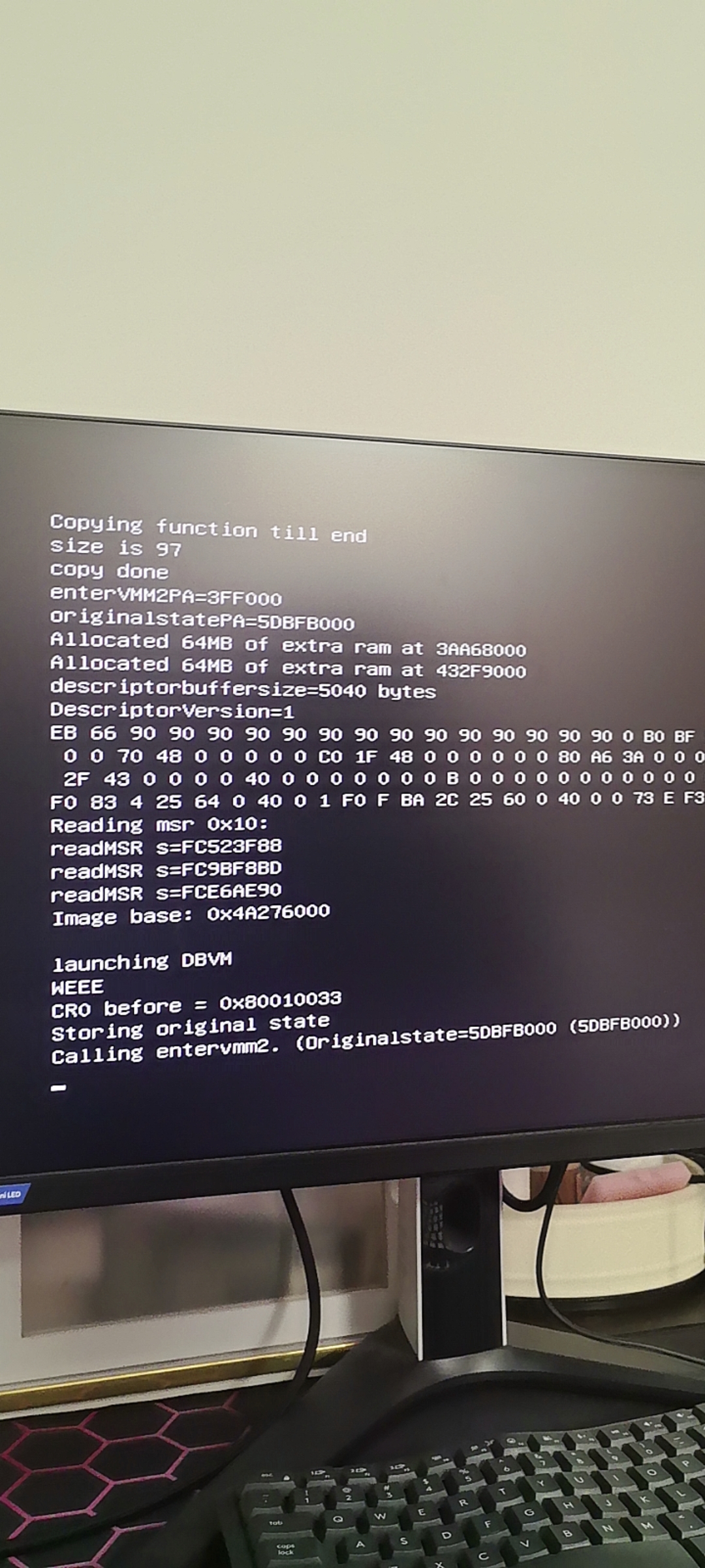

On an ASUS motherboard, loading DBVM via UEFI with Secure Boot already disabled sometimes freezes when the first CPU enters DBVM, and other times when the last CPU enters DBVM. In all cases, it freezes during the call to enterVMMPrologue.

I found that all APs have entered virtualization and eventually got stuck, without returning to the UEFI menu. Could the issue be with this line: SystemTable->BootServices->Exit(ImageHandle, 1, 0, NULL);? It's an ASUS motherboard.

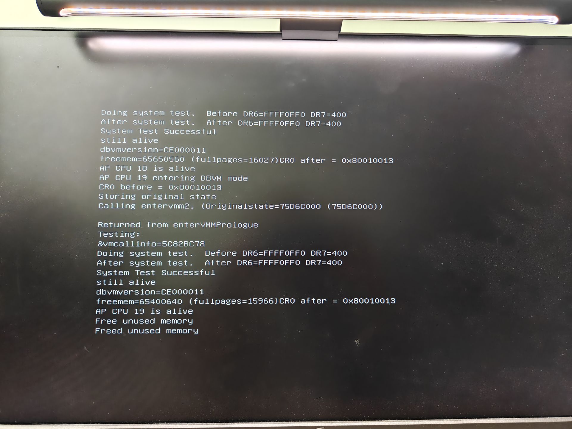

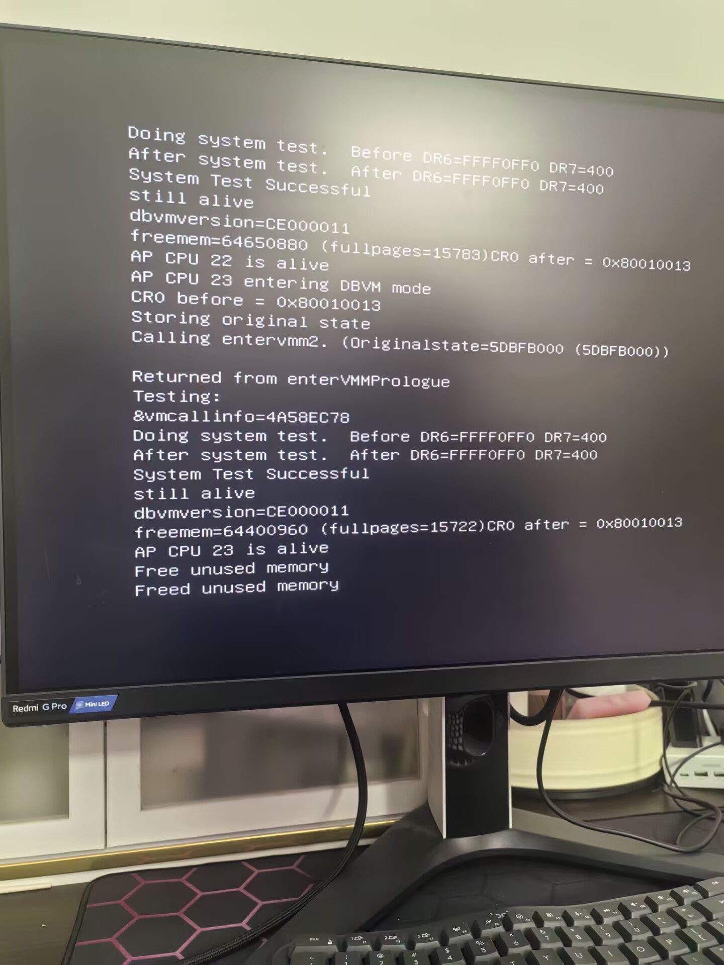

This CPU has 24 cores (0-23). 23 APs have successfully entered virtualization, but the system halts at this point. When I press Enter, it re-enters DBVM (I have made some modifications to DBVM, disabling nested virtualization), which is why it gets stuck as shown in the second screenshot.
This issue occurs on some motherboards while working normally on others.

After my testing, I found that after the last AP entered dbvm and returned to rEFInd, the rEFInd interface did not display, but I could use the keyboard to select and boot into Windows.
