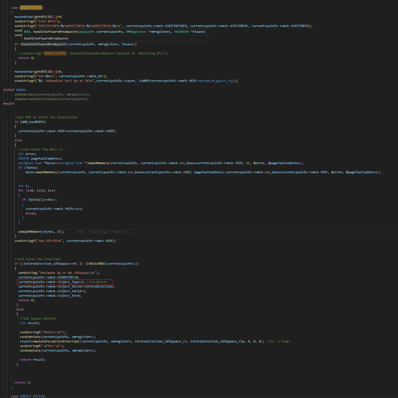

Upon reviewing DBVM’s source code for handling VMEXIT_EXCP3 (breakpoint exceptions), I found this snippet:
sendstring("Realmode bp or No idtbypass\n");
currentcpuinfo->vmcb->EVENTINJ = 0;
currentcpuinfo->vmcb->inject_Type = 3; //exception
currentcpuinfo->vmcb->inject_Vector = int3redirection;
currentcpuinfo->vmcb->inject_Valid = 1;
currentcpuinfo->vmcb->inject_EV = 0;
return 0;

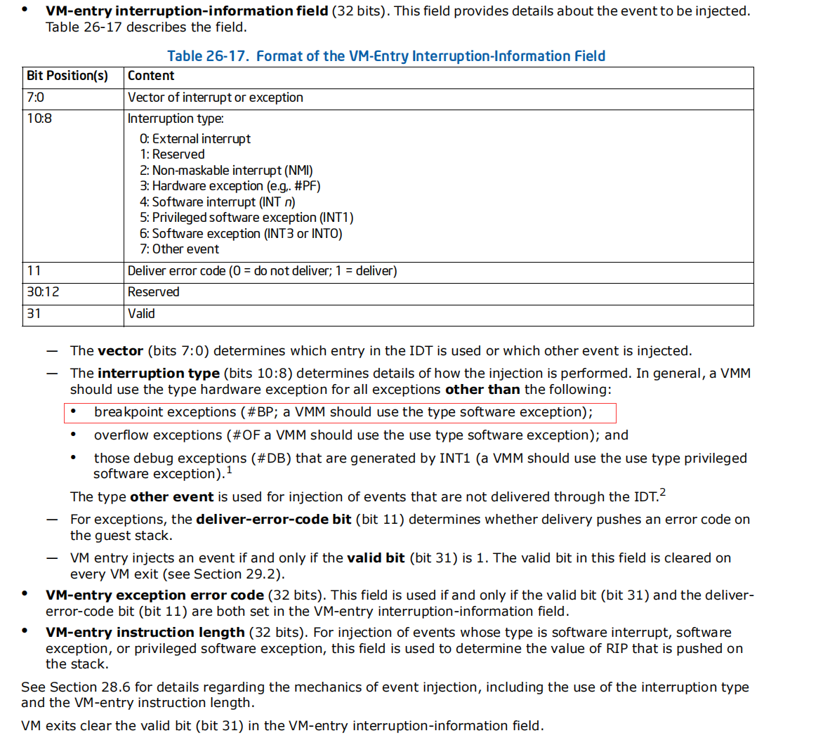

However, the ​​Intel Manual​​ specifies:
​​Interruption Type Encoding​​:
0: External interrupt
1: Reserved
2: Non-maskable interrupt (NMI)
3: Hardware exception (e.g., #PF)
​​6: Software exception (INT3 or INTO)​​
— The interruption type (bits 10:Cool determines details of how the injection is performed. In general, a VMM
should use the type hardware exception for all exceptions other than the following:
• breakpoint exceptions (#BP; a VMM should use the type software exception);
• overflow exceptions (#OF a VMM should use the use type software exception); and
• those debug exceptions (#DB) that are generated by INT1 (a VMM should use the use type privileged
software exception)
The type other event is used for injection of events that are not delive
Could this potentially be the root cause of the issue?​​
PS: After enabling DBVM, I can still set breakpoints normally when debugging my program in VS2022, which puzzles me
Intel manual
 Filesize:  235.15 KB
 Viewed:  7361 Time(s)
DBVM code
 Filesize:  104.93 KB

what cpu do you have ?
