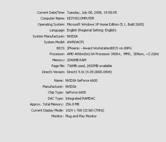

Ok, I am probably getting a geforce 8800 and a better prcoessor. HOWEVER, i do not know if they will work or fit in my computer. How could i figure this out? Currently my specs are:
Do you think it would fit? I also need a prcoessor. 200$ budget or so. Ebay <3 also might use newegg

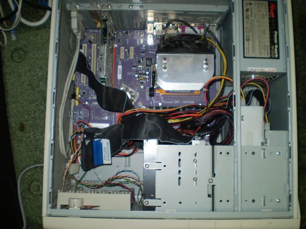

EDIT: How about i take a picture of the inside of my pc and you tell me what it would be?

or look at my old crappy computer here:
http://i158.photobucket.com/albums/t89/keith2154/insidecomputer.jpg
its like 3072 x 2304 so you can zoom in quite a bit and read it.
Daaamon
Joined: 12 May 2007
Posts: 1443
Location: Southern California
PostPosted: Sat Jul 19, 2008 1:51 pm    Post subject: Reply with quote
Doesn't support DDr2 so that shit must be old...

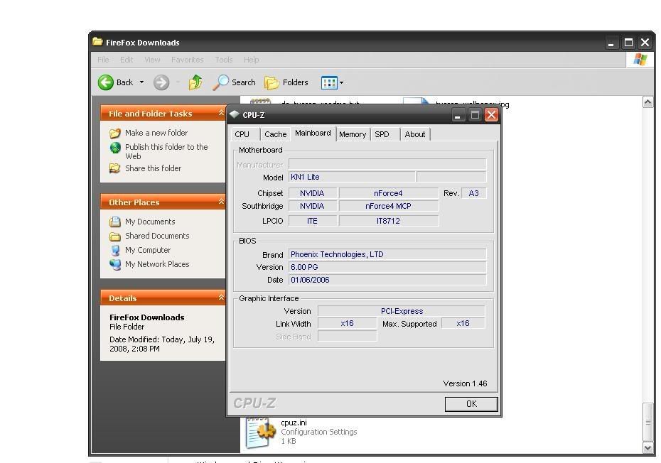

alright i got cpu z here it is:
So what should i do lol might be able to sepnd 300$ :O

Won't be able to run an Intel CPU at your motherboard, sorry.

No, it wouldn't work because your current setup uses DDR1, not DDR2.
Here's a build for $275:
Intel Pentium Dual Core E2180
EVGA 8800GS
MSI P43 Neo3-F
G. Skill 2GB (2x 1GB) DDR2-800
If you have $335, you can upgrade the processor to an Intel Core 2 Duo E7200
