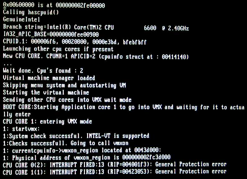

New behavior. Seems to have made it much farther this time. That general protection fault you were looking for fired. Some stuff scrolled up the screen. Tried to up arrow. When I did out popped the last line about CPU CORE 1(1). Then freeze. Couldn't scroll up to see what went by.

this is really annoying. It's just a fluke that this time your system worked more with this compile, since I didn't change anything. moved a debugline.
And then the gpf is too random

I ran it several times. The behavior is a bit erradic. About 50% of the time when I 'press any key' after the vmloader finished message, the system will not continue and instead reboots. The other 50% of the time after I press any key after the vmloader finished message, the system will continue to display the last pic in the rar file attached.. then freeze as before.
I took several pics of the operation boot after boot and the values don't change so it's hard to understand why the behavior does. Sometimes it reboots and sometimes it continues then crashes. *shrug*
I think when it reboots, the messages in the 3rd pic are displayed but they disappear via reboot so fast I don't see them. I see a very brief flash of something that might be text then reboot.
On further consideration I believe that the general protection fault randomly freezes or reboots the system. That would explain why sometimes it reboots and sometimes not. I'm probably over thinking this. Hope the pictures are insightful.

PostPosted: Tue Jan 08, 2008 11:57 am    Post subject: Reply with quote
I can see what's going wrong now.
it picks a memory region in the region above 4GB and some overflow bugs. (and since the vmloader is 32-bit this is kinda a problem)
could you make a screenshot when you only have 2GB ?
Ona side note: on 32-bit your system only has 3.2GB available
Which is why I only install 4gig on my 64bit cpu/OS system only. My 4gig of system ram and my video ram and other miscilaneous stuff like devices and ROM all have to fit into what the cpu can address. The total of stuff is well over 4 gig. A 32bit cpu would just ignore system ram until it could address what is left.
I know that's not what you're commenting on with the 32bit app. You're basically explaining that when a memory region is selected beyond what the app can access.. it barfs. Which is why I use 64bit windbg to explore regions of ram in the 00000000`00000000 range since CE is 32 bit and can't. Ollydbg is 32bit as well so I'm stuck with windbg.
You suspected ram before. We tried lowering the system ram. I've tried 2 and 1 gig total system ram in previous tests.
I'm going to reduce the system ram to 2 gig again and try dbvm 0.4h.

Posts: 26007
PostPosted: Tue Jan 08, 2008 1:07 pm    Post subject: Reply with quote
actually a 32-bit cpu can make use of that extra memory using special paging techniques. Such a shame microsoft only allows it on windows 2003 server.
and this time I see nothing weird...
the vmm is loaded at the proper location now. I'll have to check some code to find what's going on and fix that 4GB+ bug
